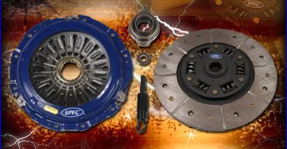

Spec Stage 3+ Clutch Kit
UUC Lightened flywheel (12.75 Lbs)
This clutch/flywheel combo is GREAT and exceeded all expectations!  Most High performance Clutches mixed with a lightweight flywheel is un-managable for street use, but awsome on the track.  For me that wasn't an option, so after much re-search I've found this combo and crossed my fingers.  The end result is a reliable HP (can handle up to 420 lbs of tq 119 ) clutch that maintains street drivability.
